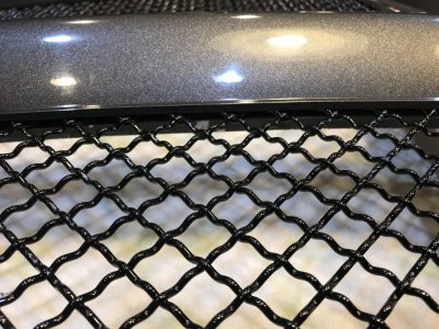

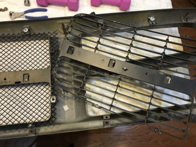

Time consuming, but not hard at all.
I also went with the powder coated aluminum mesh so it'd be easier to cut with my *****. Once I got it sandwiched in place (still in progress) I came back and just trimmed to the outside edge of the border molding.

How hard was that to cut out and what are you using to keep it in place?
That looks good
Thanks,
Not hard at all with a pair of *****, just time consuming.
I bought the powder coated aluminum for that reason, the stainless would've been a ***** to cut.
The inserts are sandwiched in by the original insert surrounds, I just cut the louvers out (I had already blacked out my louvers front and back).
I then touched up the plastic with black paint where the cut marks were left.
See?
Then I came back and trimmed off the excess on the backside to keep 'em nice and tidy on the inside too. Plus, this way I can remove the inserts if needed w/o messing them up.
They are held in very stoutly, you could bounce a rock off them if so inclined, please don't. lol
