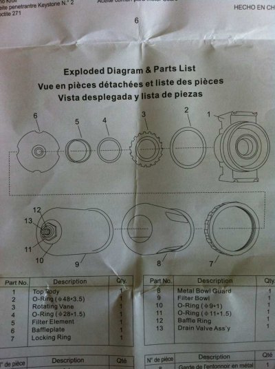

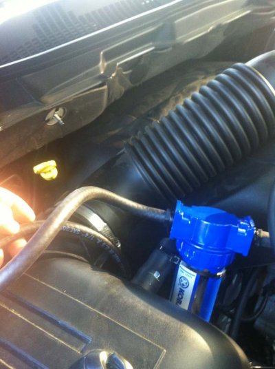

Alright guys. I installed a catch can I put together. I did not trim the hoses or mount it permanently yet, my CAI will be in this week so I have to rearrange then.
Total cost was $33.
I killed the engine. Unplugged the factory tube installed my hoses and attached them to the separator.
The can has a specific direction of flow. I installed it with the tube from the back of the block flowing through the can to the one feeding the bottom of the TB.
Here are some pictures; has anyone ever thrown a Check engine light?!?
(when I first tried to crank it I forgot I hadn't plugged the MAF cable so it didn't crank. Then I plugged it in and it cranked but with a cel. Would that be the cause and will it go away on its own?

Changed for you. Make sure the air separator has the fill line as horizontal as possible. It will not work unless it sits correctly. Glad it worked for you I have been using it on mine for 10k or more probably no issues. Did you seal the drain with something?

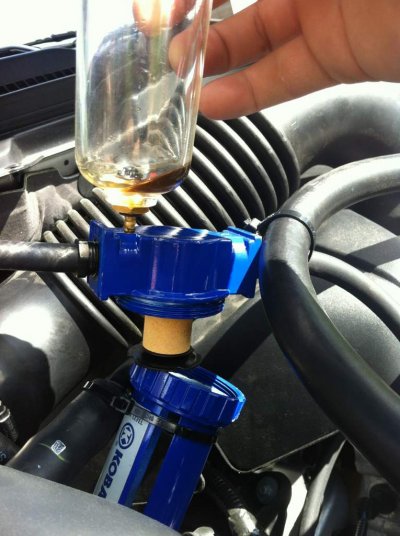

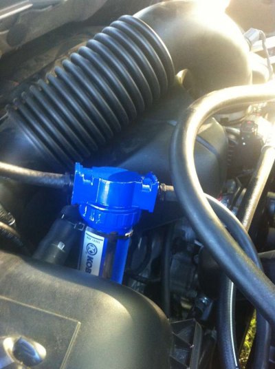

Well guys I am a believer. This lower boughtoil/air seperator shows results after just 277 miles.
It works, and made a believer out of me.
I will say this.
It shows how much these things would really cost to make for a vehicle and how much of a markup people who make them for "vehicles" have on them.
I bought blue. It was close to the mopar blue and it looks good for me to save $100.00. Mounting is gonna be fairly easy when I get the aftermarket CAI in to find an exact spot.
You can also disassemble the entire thing ( glass comes right out) and paint it whatever color you want really.
Using engine paint, caliper paint, maybe plasti dip.
Here are some pics from today.
