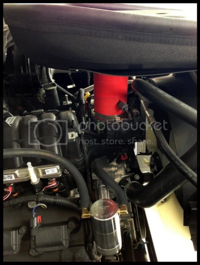

Sure thing man. Here is a link to it.
Some numbers as well. An a photo showing it can be broken down for paint of any color.
Item#- 0221014
Model#- SGY-AIR9
Lowe's Home Improvement
So what about the hose connectors and clamps? You obviously know the required inside diameter and clamp types from your effort--makes it easy one stop shopping for the rest of us if you have that handy. Thanks in advance. :893karatesmiley-thu

If I had to guess by looking I'd say 1/4" barb and 1/4npt to 3/8" barb and 1/4npt.
ramguy11
ramguy11
Mar 27, 2013
251
38
1.) kobalt air tool filter
2.) QTY:2 3/8" threaded x 3/8" barbed hose fittings (brass, black PVC it doesn't matter something that will thread in and take a hose)
3.) 4 feet of 3/8" or 7/16" rubber hose (doesn't have to be fuel line can be the cheaper pcv hose cheaper)
4.) two stainless steel hose clamps around 1.2" or so.
5.) black rtv to seal up the vent at the bottom
Thats all you need part wise.
Some stuff to mount it with is on you. However you wanna do that.
Whatever paint you want for it.
I plasti dipped my fittings black over the brass.
The hoses slide over the barbs on the fitting and really don't need to be clamped. The hose then slides into the rubber fittings the factory PCV hose was attached too. These fitting are 1/2" and too large for the 3/8" hose so just slide it in the factory rubber fittings. Put the clamps on each on and just snug it. Don't over tighten it will start to close off the hose.

Bought my supplies this past weekend. Waiting for my CAI to be delivered so I can knock this mod out. Which hoses am I connecting?
Casper
U.S. Navy (Ret.)
Nov 13, 2012
4,626
1,447
Springfield, VA
5.7L
Pull the engine cover. On the passenger side of the engine you will see a hard pvc tube connecting between the PCV at the back of the engine and just below the throttle body at the front. The rubber boots that the hard plastic tube connects to are 1/2" ID--just exactly right to fit a well lubed piece of 3/8 " ID fuel line and clamp without crushing. You just have to figure out where to hang your catch can/filter, and appropriately size your two pieces of 3/8 fuel line.
This the one?
smiley
Apr 18, 2011
6,632
2,978
Minot, ND
2014 Ram 2500 Crew
6.7L Cummins
That is the one!
$miley
audio1der
Jul 30, 2012
5,300
1,105
Airdrie, Alberta
Yup; exactly that one. Install your catch can somewhere you can access it with the cover back on, and the run a line from the PCV to one barb, and the point below the throttle body to the other barb. If the factory line were flexible you could just cut in and insert it in the middle.

Cool!
I want to install the lines, like shown here on a BTCC.
What size hose will I need? 1/2 ID????

Cool!
3/8" I/D. With lube it fits right into the rubber boots the OEM pvc line comes out of. You'll need a couple of hose clamps to cinch up GENTLY.
The BT Catch Can replaces everything with 1/2."
Big Boi
Aug 31, 2011
2,314
180
S. Fla
2009
Ok guys, I installed mine, and after a 400 mile road trip I already have at least 2 tablespoon of oil caught! :D
