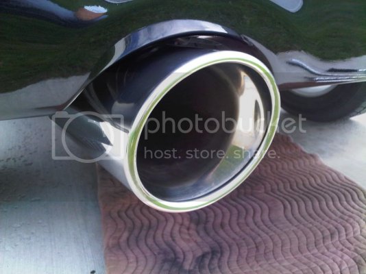

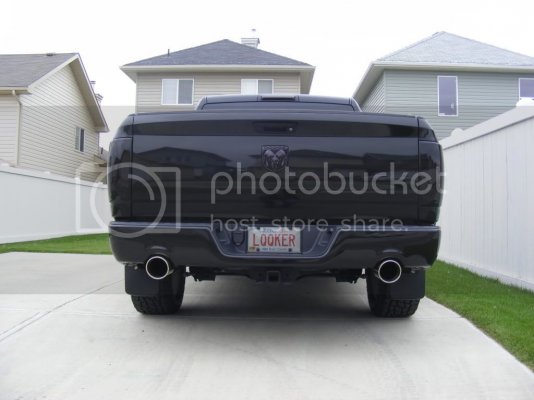

Mine is over 3 years old. found it on sale at just over $500,
sold my new stock take-offs for $200, net cost $300 and no labor DIY install.
The factory duals requirement on the website is due to the bumper cutouts. If he has swapped bumpers for the dual cutout one, then he should be fine.
The only thing a single to dual might need after you've swapped bumpers,
is a frame mount exhaust hanger on the drivers side.
Here's an old vid from a few years ago,
it's louder now with some of the packing burnt off, Y pipe mod and JBA shorty headers
<click for video>
before
after
before
after
