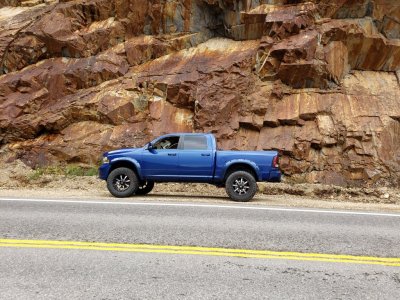

I would say maxtrac I have the maxtrac 7.5 lift on mines and I love it easy install just a bit of work 4dd7f7b53137f4c5c98f74e71e99bd86.jpgafd971201f084337fb983841483173fe.jpg I’m also on 35’s and 20x10 +12 wheels

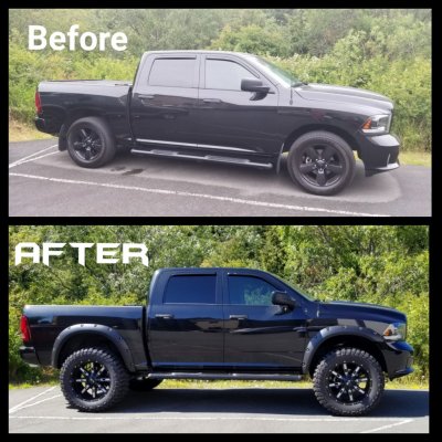

Rough country 6 inch lift. 35s 20x10 wheels with -24 offset.
There is still a rake. Rear is about an inch higher than front. Looks more severe in this picture because of the slope of my driveway. Kit is supposed to level the truck out. An inch doesn't bother me.
