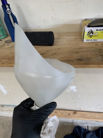

Since they decided to put the oil filter in a horrible place and it makes a mess every time I took it off, I decided to do something about it. Took a windshield washer fluid jug and cut to contour the filter/space the filter occupies. Fits perfectly and still leaves room to spin the filter off by hand. With careful maneuvering due to the tight spaces there is no mess left behind. I know I sound like an infomercial but give it a shot. It works wonders!!!

Give it a shot, take your time. You’ll be glad you did. Make sure the handle part faces the front of the truck and once the filter comes loose just have a rag ready to hold it with. Since the jug is plastic you can conform it to any shape to get it out without spilling what’s inside.

Stock size. Should’ve gotten some pics as I was removing it but didn’t have an extra set of hands to take them.

I don’t drop the filter in it. There’s enough room to lower the windshield washer jug and rest it on the steering rack and pull the filter out. Then I take the jug out.
