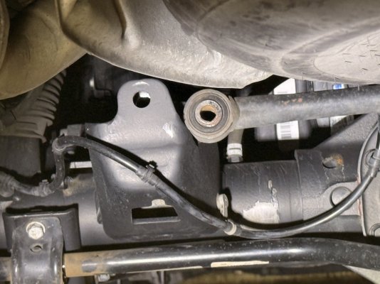

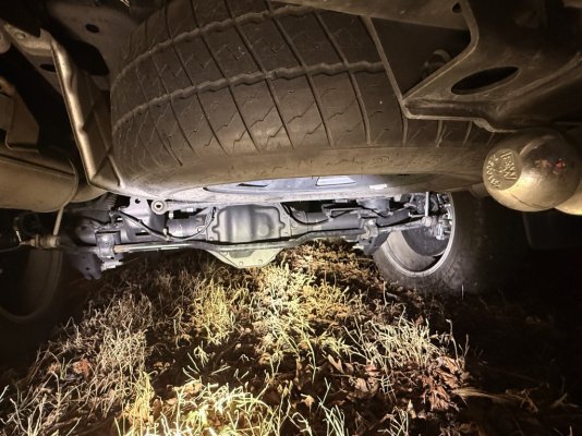

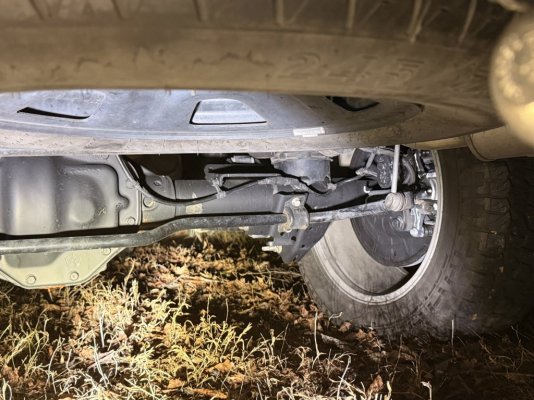

Well I’m sitting on the side of the road waiting for my tow truck with my daughter! The work done on my new rear differential was less than stellar. Look at what departed my truck! I am pissed and lucky I was able to maintain control! Two miles from home! Truck is going to the dealer tonight and I will be raising heck tomorrow morning!

DAMN! That's a pretty important bolt, like maybe the MOST important one, geesh. Guy must have forgot to put the nut on, or maybe just barely started it. I've had stuff happen like that before, and I also have been lucky.
Was there any damage, to you or anyone else? At least no injuries, it sounds like.
Wow......angels were looking out for ya..... :angels2:

Is there supposed to be a fill plug on the rear cover, or is that just a V-6 thing?
I hope you don't have any damage to the truck, and thankfully there was no wreck involved with this.
I know on the front track bars on the 2500s you are supposed to retorque after 200 miles. I found that out the hard way after I had lost the nut but luckily before the bolt fell out on mine.
It's very possible it was installed incorrectly, but there is also the chance is was correct initially but failed to have you come back in for the follow up torque check.

UPDATE: Both of us a shaken but fine. I was able to get an appt 2 minutes before the service dept closed yesterday. The parts manager heard about this last night and rushed to the dealer to look under the truck and was shocked as I was. Went in when they opened and showed the pics and expressed my anger respectfully. They had already put everything in motion to get a new nut and bolt first thing in the morning. They moved other morning appts back to take care of me. Inspected all the mounting points and check and re-torqued everything, inspected everything for any other damage and found none. They test drove the vehicle and gave it back. The warranty on the differential is 2 years. As it turns out the nut and bolt was torqued properly, it just snapped sometime after I got the truck back and decided to depart sometime Monday a week later. Later that afternoon when I went to run a grocery errand is when the torsion bar came out of the bracket. It took them about 1 1/2 hours to complete. Been driving all day today running errands and she’s running great. No highway driving today since I was still a little rattled from all the bucking she did. I wasn’t brushed off or dismissed on any concerns and they let me say what needed to be said. Got tons of apologies and they performed everything I wanted to to ensure my safety. Can’t blame them for this. Those nuts and bolts for the torsion bar are meant to be reused. Luckily this didn’t happen on my 36 mile one way trip to or from work since I have to cross a 3 mile bridge and tunnel each way. Somebody was really looking out for us and he gets all the credit so thanks!

As it turns out the nut and bolt was torqued properly, it just snapped sometime after I got the truck back and decided to depart sometime Monday a week later. Later that afternoon when I went to run a grocery errand is when the torsion bar came out of the bracket. ....
That bar is called a Panhard bar or track bar. And it would have come out of the bracket within a second or two of the bolt coming out. I've been working on cars/trucks for ~50 years, and never heard of one of these bolts breaking. How about it guys? ANYONE ever hear of one of these bolts snapping?????
Main thing is: you're all safe and sound. No damage to truck. Major luck there.
