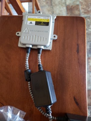

With alphaobd i do not need the canbus corrector right?
I just need to go into bmc and change to led?

No instructions came with the headlight and i was thinking i could change something in alphaobd to not need the canbus error corrector or the resistors
I got the 55w 6000k package with these lights

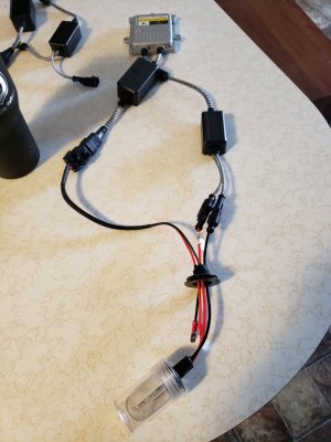

It also came with this H7 bulb and I'm lost on this lol

You need that. It’s the actual ballast that fires the HID bulb. It may have some “canbus corrector” stuff built inside of it, but still enable the high intensity discharge headlamps feature under vehicle config 3.

To my understanding i can program the truck with alphaobd so the canbus don't throw an error?
Without using the resistors

Is the H7 HID bulb?
If so is the bulb that came in the headlight assembly ok to run without the ballast?
Cause so far I'm not getting any error messages
If that's the case I'll run what's in there till i get a chance to swap them out

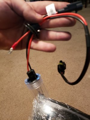

Is this plugged together properly?
If so where does the own ended red and black wires go
Thank y'all for any help

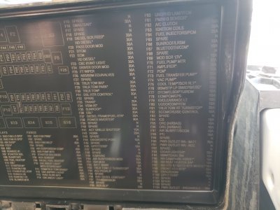

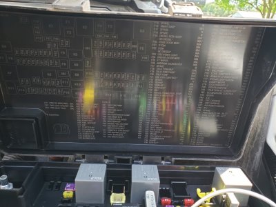

Where would i run the remote wire to
Are the spare fuse slots something i could use
I don't see a slot for daytime running lights or i would think i could plug in there and activate it with alphaobd
Electrical is definitely not a strong suit of mine

The circled pins get plugged into the h7 connector inside the headlights. So unplug the current halogen bulb in the low beam, remove that bulb, insert the black wire to the black wire in the connector and the red to the blue side.
The bulbs that come pre-installed in the headlights are h7 halogen bulbs

If you want the truck to turn the DRLs on, you would have to add wiring to the plug below the fuse block if your truck didn't come with factory projectors. There is a large connector you would have to check if you already have the wires coming from the BCM(if your truck is an SLT or higher they should be there) and then add the wiring to that.
The DRL module that comes with the Modifystreet lights gets wired to a constant and switched circuit, probably easiest to use fuse taps.

I have everything working with the halogens and i found a blank acc port in the under hood fuse box only powered when key is in acc or on
I ran red wire to battery, black wire to clean bolt since it wouldn't reach after i got it all in

I ran a test light on the spare fuse slots with key on and they were all dead lol

I found an acc fuse block to put it in
They are now working with the key cycling to acc
They have an inline fuse and module and are working great

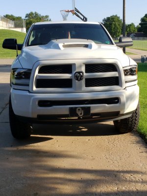

Got the lights in still need to adjust them my brights are pointed way too far upwards they look awesome and fit perfect
I haven’t bothered to check but is there a way to separately adjust the high beam projector? I know how to adjust the low beam projector but never bothered to see if it was also adjusting the high beam. The way the Ram oem lights are built, I’m guessing these are the same way and the high beam adjusts when you adjust the low beam. Correct me if I’m wrong though because my low beam is adjusted properly but my high beam is super high up and unusable.

There is only the one adjustment screw that I know of.
Disable the foglight drop out so when you turn your highs on, you have all three...lots of light downrange.
I haven't got to adjustment yet but i think there is only 1 which sux because my lows are just about right
They will be way low for me to be able to use my brights
Not sure what options to even them out lol
