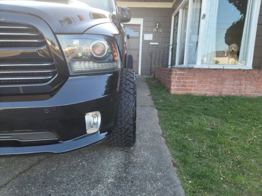

So, here it is. I've had the tires and rims for about 3 years now. I really appreciate the advice. I've taken my truck to several shops and they have not i.pressed me at all. Working on finding a new shop. Limited shops where I live, Eureka, CA but I'm sure there is one out there. I did just recently got the OBDLink MX+ and AlphaOBD app.

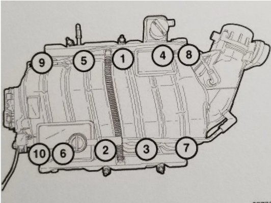

@Joshua Peterson please note...
In post #16 you said; "I've had to replace the bolts and have the manifold resurfaced 3 times now." You are referring to the exhaust manifold, this is
a common issue that most of us have had, but...
In post #3 @Daw14 said; "Have you checked the torque of your intake manifold bolts , they should all be 108 inch pounds, 5/16” or 8mm is the size.
Very many of us have found the intake manifold bolts loose. The best way to check them is with a 1/4" drive ratchet, 1/4" extension, and 5/16 or 8mm socket. The extension can probably be no more than 6" long, but the skinny 1/4" is helpful in getting to those bolts.
EDITED to add: Here is a pic someone posted about the torque sequence for the intake manifold. Please NOTE that this drawing is for the 5.7L intake in a CAR so the air pipe is facing the driver's side. Just verify you are matching front to front.
