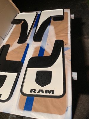

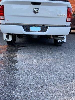

I thought I'd toss these up online. I picked up the factory mud flaps and color matched the "sunken area" on the front and rear. I think they look good, just need to figure out a mod for the tail pipe. I do not want to go full on exhaust. I am thinking cut the pipe a couple of inches out from the muffler/resonator and put on a long chrome tip that would end up at about a 45* angle, but make the passenger mud flap more visible.
Process was a wash with simple green
Taped up the flaps so as to not get paint anywhere but the center section.
Adhesion promoter
Can of white vinyl/cloth paint (its more flexible than regular paint)
