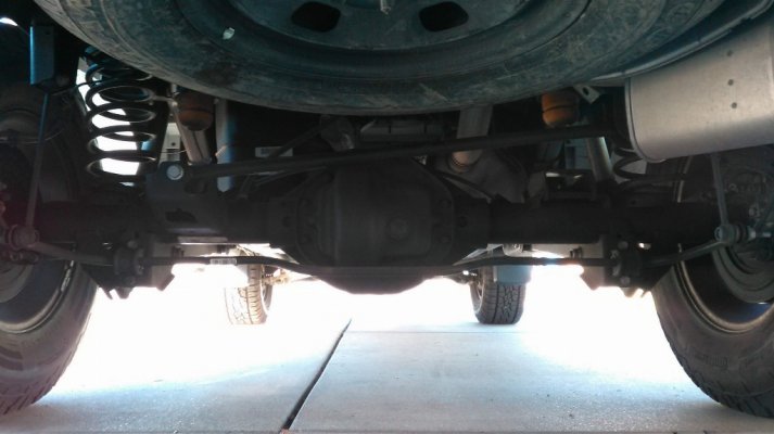

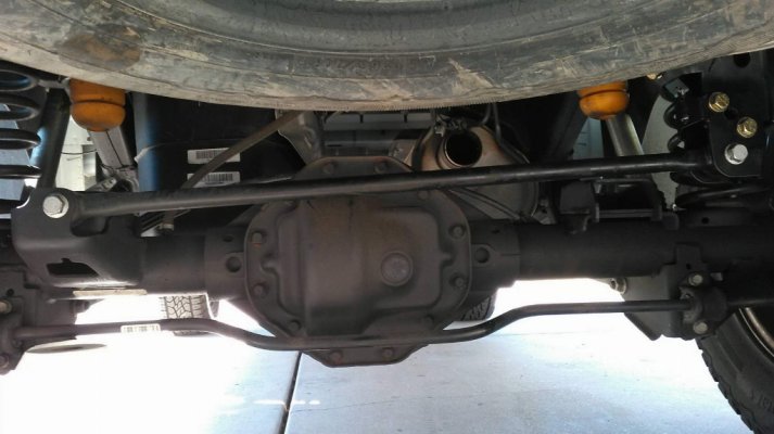

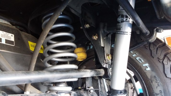

I don’t know exactly what I’m looking at lol.
When I lifted my Ram I always got this little ass-wag feeling whenever crossing a prominent seam in pavement, a railroad track, etc... it was super subtle driving straight but if I was on turn, like a curving freeway transition and hit an expansion joint that wasn't perfectly level the whole back of the truck would nudge over and it didn't feel very safe... well, maybe it made me slow down more for the corners so maybe it was safer that way? :D
So I put the drop bracket on and as you can see it makes the track bar closer to level at normal ride height. The wag went away. I don't know if there's a particular threshold for when it's needed or not needed (like 2 inches vs. 1 inch... ) but it was a good investment for me anyway.

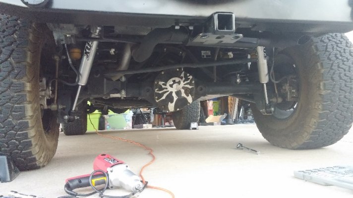

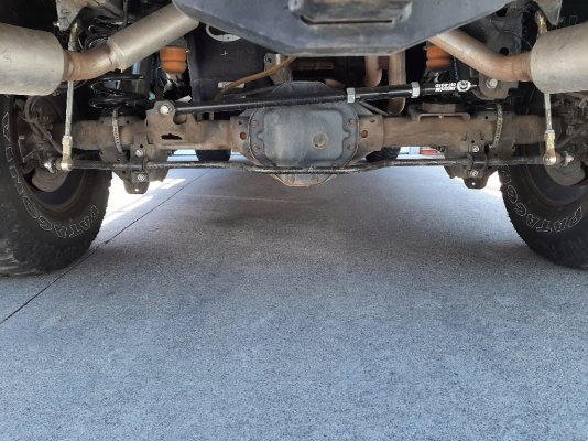

Post some pics with the angle of your trackbar. If you don't have a lift even better lets see how your trackbar angle looks like stock. You don't need a TB relocation bracket with 1" lift. Kurek has a shorty RAM so it seems they get a ton more lift than the bigger more heavy counterparts :)
2" lifted in the back, sway bar links are 13 1/4 from the stock 11's, no TB relo bracket.
50091973071_f4f0f3609a_3k.jpg2020-07-08_03-33-27 by RAM RSM, on Flickr
I don't like the location of the Carli bracket, i'd like a bracket to go on the axel side of the trackbar,
I had a similar thing in my Jeep Wrangler. in my case that wasn't a good bracket because of the strees the mount will see when you have a rig that sees a lot of flex
20836497036_c784169420_3k.jpg20150824_132259 by RAM RSM, on Flickr
Learned the hard way so my 2nd bracket was way sturdier and it mounted on the axel side, braced a lot better on both sides so chances of elongating the holes were nill.
27808196603_4fa2a46bcb_3k.jpg20160719_195116 by RAM RSM, on Flickr
Granted the Carli bracket seems stronger than the version i had in my Jeep so it may not be an issue for most (ovaled holes and eventually the bracket cracked), for me is just memory reflex though so that location is not for me :) besides the angle on my TB heap looks fine so i haven't looked at what other options there are asides form Carli when it comes to improving the TB angle.
Before relocating the bracket, get down there i'm not kidding and grab your factory TB in the middle and wiggle it , you'll be surprised how whimpy that thing is from the factory.
