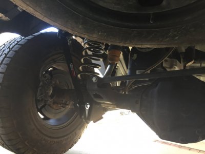

Quick dumb question for some suspension guys. What holds up the rear axle at full droop? Would it be the sway bar only? If so is the only way you can remove the sway bar completely is if you put a limit strap on it?

Stock setup when I did my coils.......the stock shocks limited it first, than the sway bar, than the brake lines, and eventually the bushings in the control arms were binding. But yea, as I unbolted thibgs it dropped more and more till it seemed the track bar and control arms were the only thing holding it in. With your amount of travel you'll for sure need good limit straps. Other wise your axle is gonna be free balling back there. With no sway bar and long enough shocks you can easily pop a cool out accidentally. Ram1500rsm was playing with his bump setup for a while and used big hose clamps on his rear coils.

As of right now I am completely stock in the rear minus the bilstein 5100 shocks. I plan to go to the dunes a couple of time before my rear end suspension will be completed and was pondering the idea to remove the rear sway bar for some more fun but it sounds like I need to keep the sway bar otherwise nothing will be stopping the axle fast enough. I do not want to count on my little bilstein shocks to stop that kind of weight.

When I was running without the rear sway I put some limit straps in there place. Quick and easy solution.

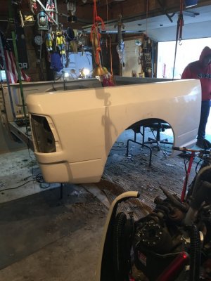

Well I got the bedsides installed and the bed on! Not the easiest thing I have ever done but was not the worst i guess either. I am not happy at all with the fitment of the driver side tail light but the passenger side fits great! Also I tried to eliminate my traction control and abs by pulling the abs valve relay ( i think it is J05 if i remember correctly) but I completely lost my speedometer which is not acceptable. So can anyone point me in the right direction on this? Really looking to get rid of both traction control and abs by going the easiest route so please let me know! I also had the truck out ripping around and unbeliveable the performance the dirk king kit offers. Absolute washed out roads up here in michigan and I was flying around without feeling a thing so I could not be happier with the front end at the moment. I do have a trip planned for silver lake sand dunes at the end of the month so I am hoping to get some sweet shots and fly around the dunes. I will keep this posted as well as I can! Still working on what rear shocks to run as well but not in a huge hurry to get the rear done due to funds and it being dune season.

Make sure you account for the limit straps stretching, plan for 1” stretch for every 12” of strap. So 12” strap will settle out around 13”. Using that info I set them at the full stretched amount 1/2” before full shock extension.
