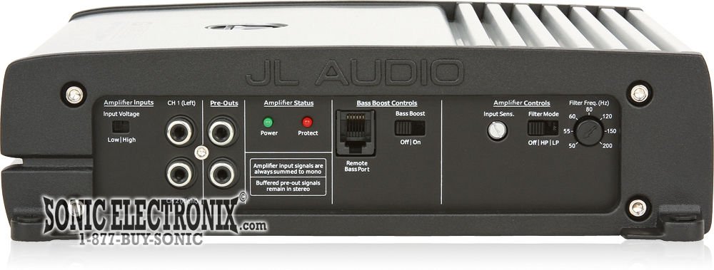

it's a JL G1300 which has no gain knob on it. The sub is a JL 10W1V2.4

try this...
starting from left to right...
Input voltage = low
Remote = Are you using a bass knob? If not, do you have one?
Bass boost = off (what this usually does is jack one frequency up for perceived loudness)
Input sentitivity (gain) = all the way counterclockwise should be down all the way down. turn it about 1/4 way up to start
filter mode = LP
filter freq = 60ish
See how it sounds then.
