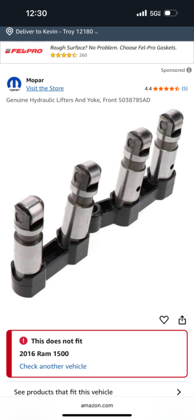

This says it doesn’t fit on mopar website. IMG_5972.pngCan anyone confirm?

5038785AD and 5038786AD are the ones I was quoted for my '15 SLT
Don't believe any difference for the '16, but hopefully someone else wil chime in.
You can message Benny at @AllMoparParts.com
Give him your VIN, and he will give you the correct part# and quote.

This says it doesn’t fit on mopar website. View attachment 567904Can anyone confirm?
Mopar is pretty much always wrong on what fits.
My truck is packed full of parts that "don't fit". Apparently My spare key fob doesn't fit, nor the water pump, the RF hub and the passenger seat airbag harness.
Oh, and my power steering rack doesn't fit either it's been discontinued! And none of the other years will work! :anitoof:
