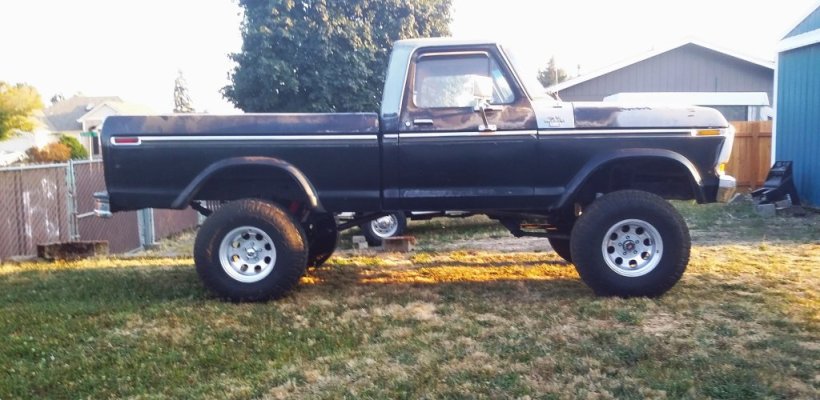

62Blazer, whe the truck is fired up it runs like a brand new truck, it isn't until you get cruising whether it's through town here or on the backroads, when cruising the rpms surge as i noted and now since this morning stalls out and dies upon slowing to a stop. and it literally feels as if someone shut the fuel off. So my plan at the moment is fuel pump replacement, throttle body replacement and if needed i'll replace the purge valve too. I did do a throttle relearn haven't tested it yet, but we'll see. In the meantime 62Blazer i appreciate your input :) still kinda like the simplicity of my 78 ford lol!!

Many years have passed since the simplicity of a mechanical fuel pump on your 78 fotd. A bit of work to replace an electric fuel pump that is working when you drive it and would have more stable pressure when you come to a stop and idle.
