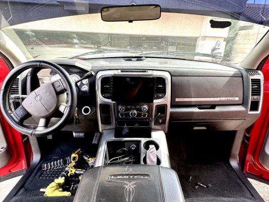

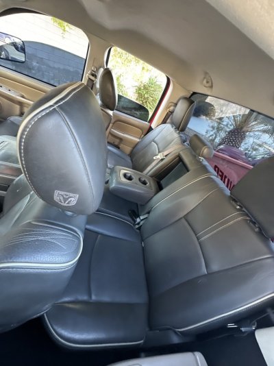

Good call on the pics and some further information. I searched the local wreckers for a 2014 limited ram by using the body code for the limited model. I pulled pretty much the entire interior from the truck I found. My airbox in the 3rd gen had to be modified to adapt to 4th gen air ducts, and my column shifter had to be cut and extended 0.5inch. There was a bit of trimming that needed to be done around where the A pillars fit with the dash but the dash was nearly direct fit.

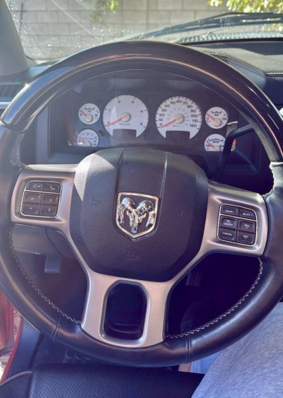

For the steering wheel I had to take apart the cruise control/button modules and rework the board. I cut and remade traces and resoldered resistors to match what my 3rd gen was looking for on the signal wires for cruise control and various buttons. I did the same thing for the headlight switch (although my dimmer still needs some work). I may make a full PCB design and send it off to be made for the steering wheel controls and the headlight switch. I may sell these for other people looking to do the swap.
Next I will be swapping late model 3rd gen door panels painted black to match the dash, and I want to redo my headliner with black suede.

You make an interesting point about the integrated HVAC module. The manual controls arrive today for testing, and I now understand why I couldn't find a standalone HVAC module at the wreckers - I was searching based on my incorrect assumption that the manual controls used the separate module on the right side of the dash. Your point also has me thinking: could the system work by just connecting the manual controls behind the dash using CAN_IHS (Hi/Low) to create a network with the head unit, along with basic power and ground? I'll double check this as well.

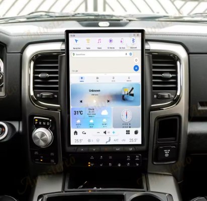

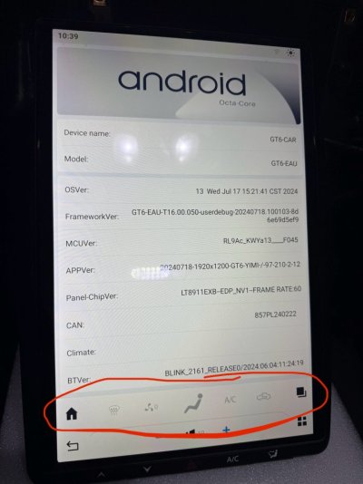

Here is the 14.4" screen for those that are curious, the second pic is my head unit and you can see the HVAC controls are grayed out, swapping canbus protocol on the head unit to various vehicle models hasn't enabled them either.
If it's just initialization the head unit is seeking then I can record the CANBUS messages and develop an esp32 with a can-hat to satisfy the head unit. The head unit might need real-time HVAC actuator and fan status updates beyond initialization, but we shall see. I would also share my 3rd gen to 4th gen android head unit and harness pinouts once I've completed the project.

View attachment 557821View attachment 557814View attachment 557822View attachment 557815View attachment 557816View attachment 557817View attachment 557818
View attachment 557819View attachment 557820

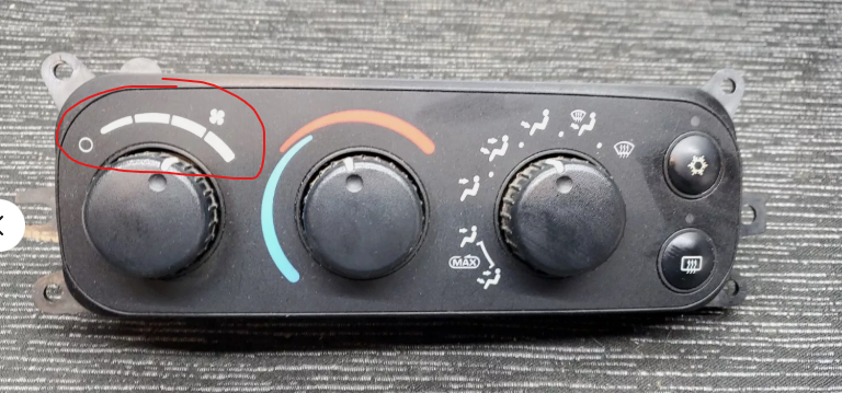

I see you're a mad lad! What a conversion! Beautiful Truck!

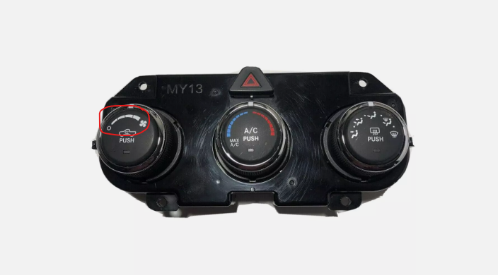

To be clear, the bezel you have for HVAC controls in your picture is the bezel that has the remote HVAC module on the passenger side in 4th gen trucks. SO for that bezel to ever work, it would need the remote HVAC module to receive commands (at the least).
I haven't messed with those Tesla style radios in years and it looks like they have come a long way, but they used to have an external CANBUS module that would interface with the trucks CANBUS in order to send commands for HVAC controls and programmed options that would be activated from the radio.

Haha thanks! You could say I'm more autistic than mad for attempting this but either way, lmao. I'd like to give back to the community with modification addictions like I have
And yeah the controls in the above picture were just what came on the truck I pulled the bezel from. I knew right away those wouldn't work with my 3rd gen airbox without full canbus modules and sensors communicating properly. I'm glad you pointed out the operation of the HVAC Module with what control systems.

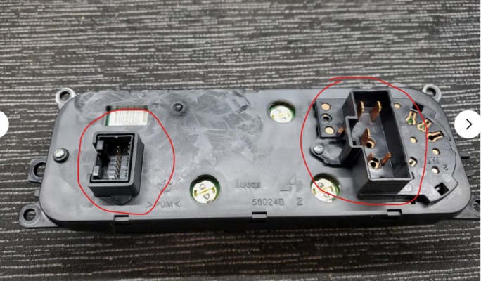

This is the HVAC Controls from a 3rd gen:
Front has 4 speed fan selector
Rear plugs, (Right) has 5 pins for fan speed, (Left) is controls for mixing/flap actuator positions (as well as evap sensor, lamps, etc)
4th Gen Manual controls (typically found in base model 2500/3500's):
Front has 4 speed fan selector (Same selections on front as 3rd gen)
Rear plugs, (Right) has 5 pins for fan speed, (Left) is controls for mixing/flap actuator positions (evap sensor, lamps, etc) as well as CAN_IHS(+/-). What's interesting is the manual controls actually control the AUTO Headlight function from the sun sensor on the dash. 3rd Gens don't natively have AUTO Headlights but now with the dash swap it is possible to add it.
Nearly all the connections needed for the 3rd gen airbox are present on the 4th gen Manual A/C Controls. I believe when I connect the 4th gen manual controls, it should operate the Fan and Airbox actuators in my truck as I have wired.
I ordered the Android head unit optioned for manual controls thinking the head unit would operate the airbox on analog signals just like the controls do. Now here I am scratching my head as to if my wiring is correct or if there's missing CAN messages. I may tear apart this 4th gen controls box to see what the PCB is doing.
This is the HVAC from a 3rd gen:
