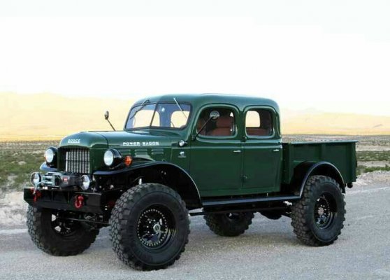

Think of the Power Wagon as an HD Raptor, except it's been around since the 1940's.
Today's Power Wagon receives a 2-inch factory lift. Different shocks and springs that allow for greater articulation than any HD truck on the market. 3 differentials, manual transfer case, 4.10 & 4.56 gears (depending on years), disconnectable sway bar, 17 inch wheels with internal bead locks and 12,000lb Warn winch all from the factory.
It's basically a Jeep with truck body.

That thing is f-ing sick! [emoji1360][emoji1377][emoji1598]

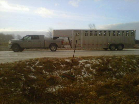

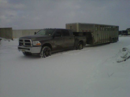

I have driven a ram 2500 megacab 5.7 hemi pulling 17,000 lbs. It did sit a bit low but it has amazing power! Pulled it quite easily. It did that trip once a week for a couple years. The tranny and engine is still good after doing that for a couple years. I am very impressed with it.
I would have loved to see that.

We would fill it full of chicken crates full of ducks. 120 lbs a crate. Full width hight and length. 17,000 might be off but not by much.

That does not look like 17k. I have a cattle trailer that size that is way older then that one so it is all metal instead of aluminum and it isn't even 6.5k on the scales empty. A 17k load would put those trailer axles way over their GAWR which is why most trailers with a 17k GVWR are three axle trailers.

And yes. It was way over the legal limit the truck and trailer. The ducks weigh 11 lbs. 10 to a crate. 5 crates wide. The width and length.
