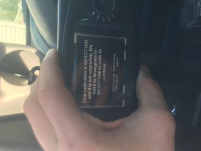

Well went in for my recal to get fixed today and unplugged my t-1000 and hid it and went to go push my tune from 87 Oct to 91 and got this image.jpg
Any idea why this would be?

The dealership reflashed your PCM with a revision that is not supported by Diablo. If you hit agree, the tuner will put the old revision back in the truck and reload the tune.

You always want to return the truck to stock before you give it to the dealer for work that may require a flash or even a PCM inquiry with their scan tools.
If you agree with the revision, the Trinity will re-write the PCM back to the prior version.
You can also call DiabloSport and read them the new version. They may have an update and process that will make the Trinity program compatible with the new version.

When I hit accept it said to hook it up to the Ds downloader and update the trinity. Now that I am looking at the paper work they did the new flash on the pcm. So I'm I screwed now because it was married to my truck when the updated the pcm or do I just need to update my trinity?
if they flashed it while it was tuned you trinity isn't going to recgonize it cause it's back to a stock tune now. you'll need diablo to unlock you tuner from what it sounds like to me. I've read on there forum that if you show proof of the flashing I guess they unlock it for free. most charge about 100$ to unlock them

If you didn't return to stock before taking it in, then your tuner is locked. Diablo charges about $150 to unlock it, or if they are in a good mood, they will sometimes waive the fee if you have a receipt showing that the dealership flashed over your tune.
