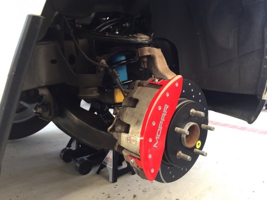

For that price you can buy drilled and slotted rotors, upgrade to ceramic pads from Auto Zone, which are free replacement for life too, and do the job yourself. It's not that hard. But, yeah that price doesn't surprise me from having it done. I put D/S rotors all the way around myself, not bad at all if your at least moderately mechanical.

for daily driving drilled and slotted rotors are like installing chesse grators on your truck, they good but are one of the worst things to install on trucks

Mine have been fine for 2 years on the RAM and I've used them for over 15 years on my GTP.
Yeah if you want to autocross or do very heavy towing I would not run them but on DD they are fine.

Absolutely not true, I've been running them for years without any increased pad wear (ceramic) and great stopping ability. Maybe you had/have ****** rotors?
