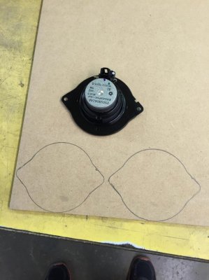

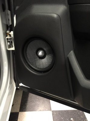

Thanks guys, thats as of last night, the QS tweeters are in the dash 3.5" location, Tim made plates and mounted them there.
Matt agree, sure wished they were this way OEM.:naughty:

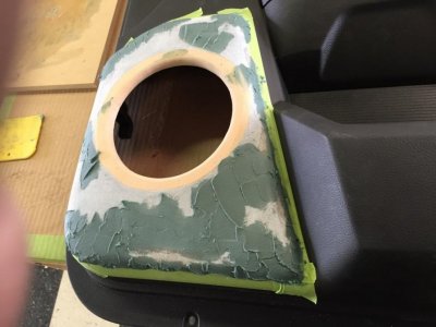

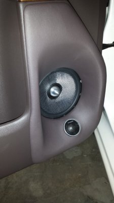

Nope, Tim did a set for our new 2015 Silverado we did for SEMA and I fell in love with them. So I had him do me a set, just so it's different than the normal door plastic 6x9 opening.

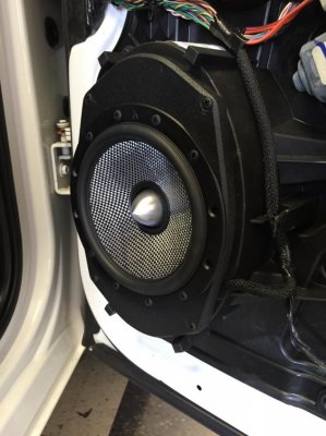

Trout, Im using the new IQ amps with time alignment, etc as well...31 band EQ onboard. Using a IQ500.4 on one set of QS674 and one IQ500.1 on a Comp Q 10" subwoofer, small sealed, about .70 cuft.
