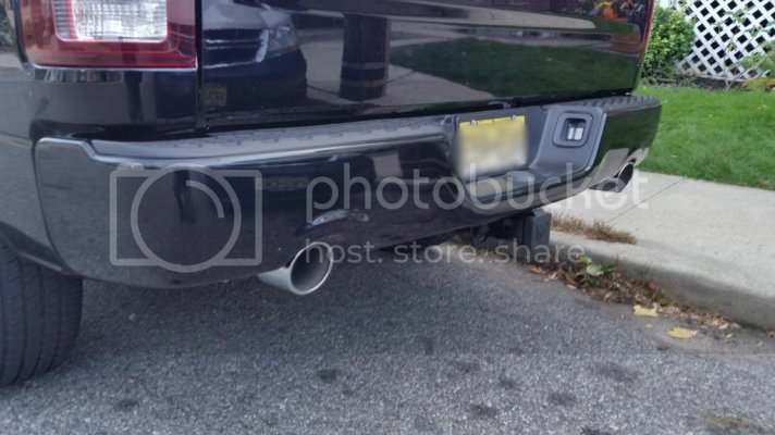

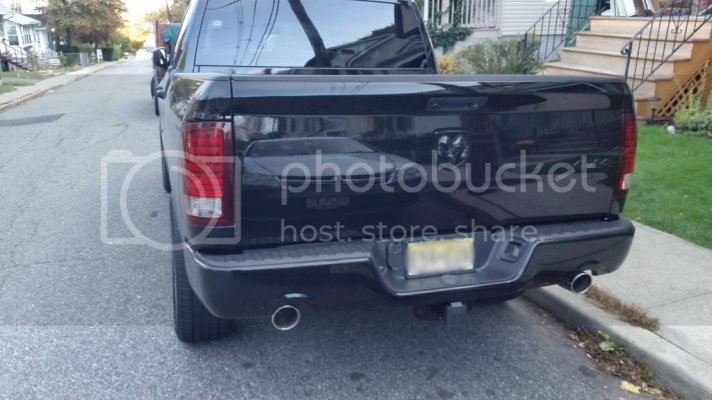

Well guys i went ahead and finished the install of the exhaust. Basically pulled the muffler out and knotched it out for the stock tail pipe alignment pins. The exhaust is pretty centered, might look alittle off (viewing angle) in the pic but its pretty good. I like them tucked in more than sticking out like stock. The tail pipes can not move or rotate as they are locked in now.
So here are some pics of the knotching of the muffler exits and the end result on the truck.
knotched muffler for alignment pins
This is the inside of the muffler… basically straight through with a y at the back end.
overall its a nice sound, not noticeable at idle (only on cold start) and gets louder… still some resonance kinda in the 1600-1800 range but not as bad as stock I think. She sounds real good above 2K to redline.

Got mine installed Sunday and am loving it. Didnt do the notches yet so i'm living with the alignment right now..it's not horrible. I'll have to do that next. Overall I'm more than pleased... $70 well worth it. She gets loud when u get on it and is nice and quiet when cruising.
