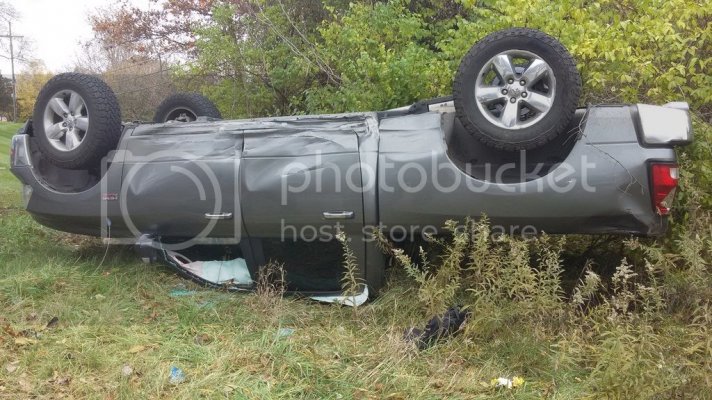

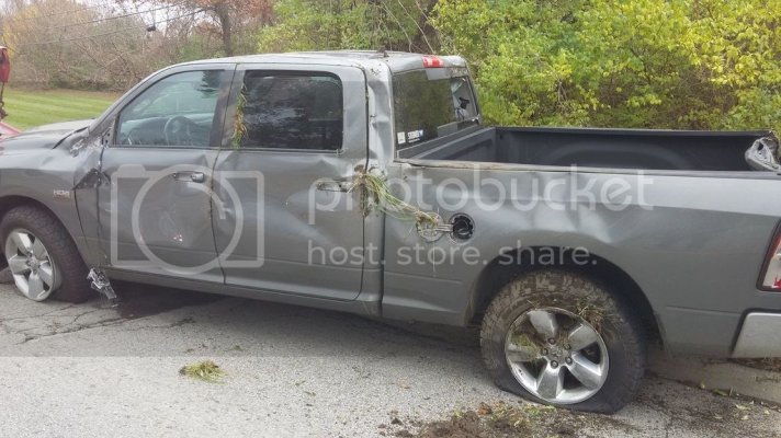

When my low fuel light came in today it said I had 46 miles to empty, the gauge was on E but it still only took 26 gallons of gas, so I had 6 gallons remaining. This is the same behavior I’ve had before the U07 update so I’m thinking U07 doesn’t include the fuel tank update but the U05 did.
OMG! THAT explains it!
I just found out the 2013 I had did have the 32 gallon tank too, but in thinking back when the gas idiot-light came on and the ODO/efficiency gauge said I was "0" miles from running out, the most I could ever get into it at fill-up was @26.5 gallons. I actually had 6 gallons of fuel left over!?! That's why I never ran out!
ROTFLMAO...
Well, I guess I don't have to worry about that now, considering what happened to me last Friday afternoon
She's dead.....
:(:confused::eek:o_O:angels2:
