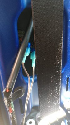

Sorry this writeup won't be quite as detailed because it was friggin hot. It's 97 outside and about 95 in the garage. I started with the hardest part, running the power wire. I drilled a hole thru what looks like the clutch block off plate. I put a grommet in it and passed the wire thru. Where the wire passes near the e-brake assy, with it's metal edges, I put some split loom on to protect it. I pulled the drivers front and rear threshold trim (well the back not all the way, it's trapped by the back seat). You have to move the driver's seat all the way forward to get the b pillar trim off.
I used vampire taps to get the rear drivers speaker wires. In the B pillar there is a connector that connects to the harness coming from the door. I disconnected it to get some room and tapped right down near the plug. I ran some speaker wire along the same path as the power wire. I also ran the amps remote volume control up to the front.

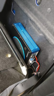

I took the paint off the seat frame near a hole that was already in it and used a nut, bolt and some washers to secure the ground with a really good bare metal connection. Then I put the amp in and hooked it all up. The sub is pretty much trapped by the seat back when it is upright, so I just got some velcro strips and velcro'd it to the back wall. Just to keep it from sliding around or falling over if the seat back is tipped down.
I zip tied all the wires near the amp up, and I probably could do a better job, but again I was hot. You can't see them unless you tip the seat forward, so I not worried right now. Maybe this WINTER I will clean that up!!! :flamingdevil: That's how I felt!

IMG_20180701_134004.jpg Here's where I tapped into the speaker wires. They are gray with a dark green stripe and gray with a light green stripe. I forget which one is +. I made a note and hooked up to the amp correctly.

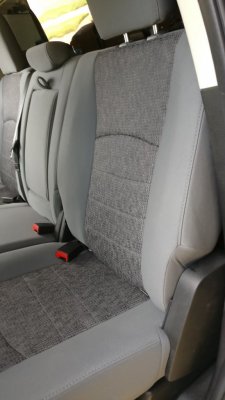

IMG_20180701_144128.jpgNo wires hanging out.

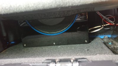

IMG_20180701_144135.jpgOOPs, a little messy, but it's zip tied so it can't get hung up in the seat.
IMG_20180701_144144.jpg And there it is...velcro'd to the back wall.
And FYI, it will not fit UNDER the seat. The seat won't fold all the way down. I would guess it's maybe 3/8" too tall or maybe a little more.
As for sound...it's not a comp system with 2 12's that is for sure. But I have the remote volume below half way and at 20 on the head unit volume it will make the mirrors vibrate. I need to fine tune it, but the bass hitting pretty good just at normal listening levels, 12-20.
One of the ways to get the back seat to tilt forward and gain access to the back storage area is to put spacers on the bolts that hold down the seating part of the seat. Do you think if say, 1/2" spacers were put on the bolts under the rails for the seat bottom a guy could gain enough height to install the Rockville powered sub on the floor?

How did you get the back to fold down
@Cory408 There are a few threads about it. The back of the seat has two 'prongs' that engage hooks on the back wall. If you notice when you cycle the bottom up and down, the back also moves up and down. There are two ways to do the mod. Loosen the four bolts holding the seat bottom in and put spacers-washers under them until those prongs will disengage when the seat bottom is about halfway up. Or I chose the cut of part of the prong method. There is a teflon guide on them...I guess so they don't rattle or squeak when going up or down. If you look at the last pic of my speaker post, you'll see there is a square, bracket so to say, of the teflon. You can just cut off the prong right there. You have to guide the back now when it goes up and down. If it leans forward at all, it may only engage one prong or none. But if you push the seat back back and lower the seat it works fine. I only did the driver's side but people have done both. There's quite a bit of storage back there. someone's thread they put an AR-15 back there. Perfectly hidden and no one except someone on these forums even would think the seats fold.

I just tapped into the driver's rear speaker. It sounds fine so far. I guess if you played some techno or 60's pschodelia, you may have an issue. Plus it was hot and running the power and wires just on the driver's side was enough for me!

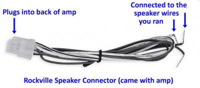

I hope you don't mind all my questions...
When you ran the speaker wire it looks like you used the typical 16 gauge paired wire. Judging by the photo of your tap into the factory speaker wires it looks like you crimped on some female connectors onto the bare ends of the speaker wire you had and then used T-tap (vampire taps) to connect these female connectors to the factory speaker wiring. Is this correct?
Then you ran the speaker wire from the taps back to the amp unit whereupon you twist connected the speaker wires onto one half of the wires on the Rockville supplied speaker connector that plugs into the back of the amp unit. (You only used one half of the wires on the Rockville speaker connector unit because you only tapped into the driver's rear speaker and not both right and left rear speakers.) Am I correct?
Here's a photo of that connector:

You are correct. I used the speaker wire that came in the Autozone amp wiring kit to run from the vampire taps to the 2 wires on the Rockville. I only used one pair of high level inputs on the Rockville. There are 5 wires in that harness...1 is a ground, which I connected.
Also, the velcro was a big fail. The seat back DOES NOT trap the sub. So it slid around yesterday and quit working. I will get out there shortly and see if it came unplugged or shorted and blew the fuse.
AND figure out someway to strap it down. I am not drilling holes into the body of my truck, so I need to figure out how to mount it using the seat brackets.
How long are those five wires on the speaker plug-in harness?
(I've got an email into Rockville with this question. Haven't heard anything for several days.)

Well I found the problem. Sub slid over and hit the auto power on button. LOL. So it is really freaking hot and I have the garage packed with stuff to get ready for the flooring guys to come, so I took the easy way out for now and wrapped a towel around it to wedge it when the seat is upright. Once I get this flooring done, I'll see what I can do to permanently mount it.
@PowrRam As far as that 5 wire high level harness, I'd say the wires are about 6-9" long that come out of it.

I think I will weld up a bracket that the sub slides into and attach that to the rear seat mount bolt. I'll probably use some light angle iron and make something resembling a sleeve. But beyond that, I think the sound is still great. I tweakeded the low pass down to about 70% and turned the gain down a little more. Now for 85% of the songs I have the remote know half way. Then I have max adjustment up or down to tune to my liking.
All in all great bang for the dollar!!!
