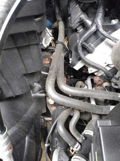

Thanks crash. Here a pic I just took. The two upper hoses are the supply and return for the heater core.
Those two lower hoses attached to that plastic coupling looking thing go over to the thermal unit on the transmission best I can tell. Oddly, they're both plumbed into the lower radiator hose.
crash68
ACME product engineer
Mar 20, 2016
12,362
21,523
3.0 EcoDiesel
It's possible that plastic piece has a restrictor or a flow scoop between the taps so flow will go out and come back.
Wonder if the 3 way is gone from all the engines or just the Hemi?
No restrictive valve in it. I have a spare. Busted a hose and had to order it the hose and it only comes as an assembly. It’s completely open and free flowing
The other ends of those hoses must go through the TMU and possibly an oil cooler (I think later versions of the Hemi have them) which would be plumbed to the other side of the pump somewhere.

That's so weird. I have no idea how coolant flows though the fluid heater on the transmission if both hoses are tied into the same place.
The other oddity I've noticed is that the transmission fluid almost never gets to 185F on my 2019 hemi ram. If it does, it's only after a 30-40 mile drive and my ambient temps have been 80-90F for weeks. The 8spd in my 2017 Pentastar Ram 1500 would get up to 185F much faster and had the 3-way coolant valve.

The line for the trans comes off there and back at the water pump. The other hose goes to the oil cooler and back to the water pump.

Maybe on the 2017+ hemi Rams?
I know my 2017 Ram 1500 pentastar had the 3-way and I'm pretty sure my brother's 2019 Ram 1500 classic w/ pentastar has it too.

So is it just a constant flow of coolant to the TMU on the new trucks?
That's how it looks. Like I say, oddly enough, it takes way longer for my 2019 w/out the 3-way valve to get the transmission up to 185F than it did with my 2017 Pentastar powered Ram 1500 with the 3-way.
Looked into it a little more and looks like the 3.6 trucks still use the 3 way valve. The hemi trucks stopped using it in 2016.
