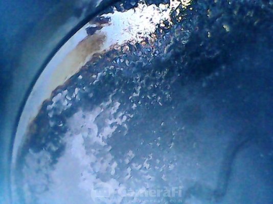

We also did some tests at bitog also posted like the thread above, especially hemi395 who also boroscoped his. Bottom, line, nothing has been proven by boroscope to clean the rings and ring seats like redline si-1, if there was, I would mention it. You are looking at piston tops, and as you see what happens first, the first cleaning you get is on the edge of the piston, as in where the rings are.

This is hemi395's piston after using reldine si-1, see the top of the round piston and where the cleaning starts. Corey was the original, now off shoot tests show the same thing, non better then that site posted, very thorough. That is boroscope camera look at piston top. No, techron will not clean as well, proof in that other test, in fact nothing will, he also tried other PEA additives with pics nothing as good.

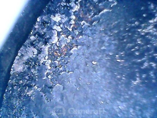

before pic would help, lol. This is corey's piston before si-1 but after amsoil ;pi and maybe techron, I forget. Maybe he chime in. @Hemi395
look at the edges, this is how oil gets through old rings. Carbon build up creates little galleys. Eventually rings fail and nothing will help, but cleaning them prolongs their lifespan.
The before and after is a big difference. The redline comes tomorrow and I'll give it a try! I've already run seafoam so should be good there
