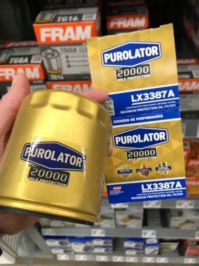

All indications lean towards the FE line being discontinued and not sold elsewhere. Walmart has been slow rolling the resets and my local Walmart was changed over a couple of weeks ago for the new 20K mile rated Purolator LX series of filters in a Gold paint can that is using the FRAM numbering format. There is also a new supplier for the Mobil 1 filters (Premium Guard) and they seem to be way better quality than the outgoing ones but they are Asian made and will vary by SKU (Vietnam, China & South Korea.

Not one of the better youtube videos on filter build or testing, but it's early. Hopefully a couple of our faves will step up and give it a real test/review soon.
One thing nice, and probably by sheer chance, the filter in this video is the LX10060 which is the OEM (smaller) size recommended for the 5.7L Hemi, so we at least get to see our own filter opened up...

Wal-"mark" where I reside, still has the FRAM FE and XG on the shelves. I guess it's just a matter of time when those are pulled and get "shelved".
When the new Wal-"mark" Purolator 20k oil filter hits the shelves here, I'll pick one up and cut it open for a look see.
