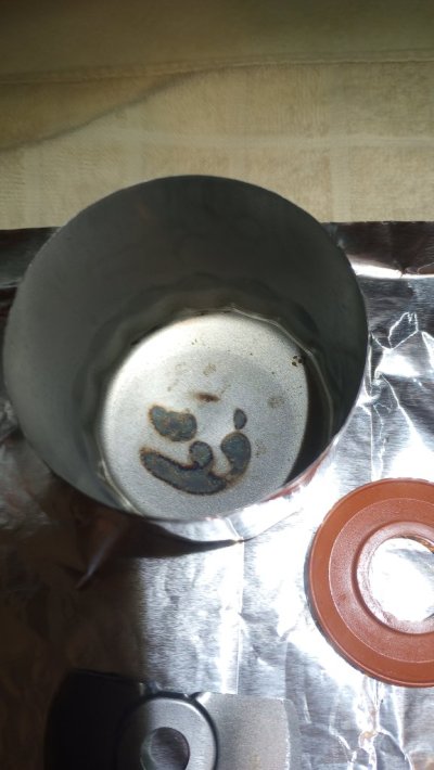

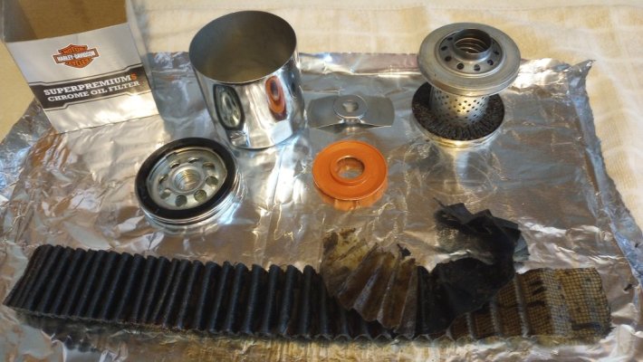

For fun and us H-D owners, a few cut open pics of my 2010 Harley-Davidson 96 cube V-twin's "Genuine Harley-Davidson" oil filter @ 2600 miles(last oci was on 6/2020, it sits a lot and figured it needed an oil change regardless of accumulated miles since the last oci).
Imo, this oem replacement chrome oil filter that is sold at the H-D dealership is "all flash and show" ... the filter media alone isn't worth the $$ and that, imo is where it matters most. It was easy peasy to tear it away from the screened wired backing(not sure what it was, synthetic cardboard?)at least it had that, and that's a good thing ... the rest of the oil filter seemed decent.
The baseplate is good and the gasket is thick, but the outer filter canister was a little flimsy.
The anti drain-back valve is as it should be, an durable silicon.
Don't know about this filters by-pass valve, but it states there is one ...
... I slapped another one right back on as I've done for many years ...

Yeah, that's just a crappy, old-timey paper one. This is the only one I could find with supposed synthetic media. Yeah, it's Chineseum, yet it appears well-built visually. I haven't cut one up. I run it on my M8 H-D.
