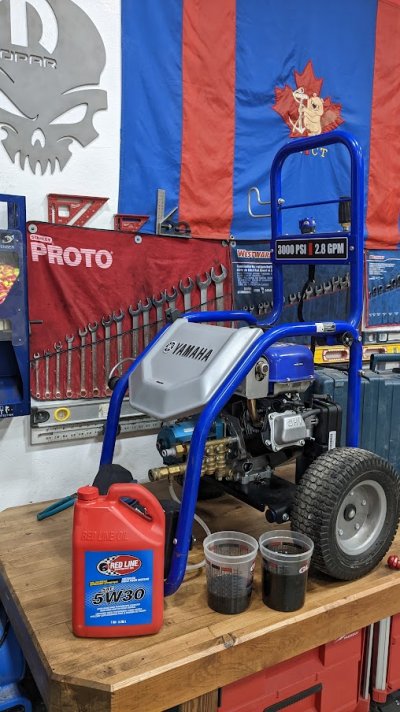

I change mine out once a year on all 3 of my vehicles
All running RL5w30
