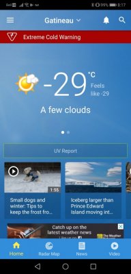

Dang it looks fun to work on your truck on such a nice day...
:patriot:
Edit:
That's -20F in freedom units
Keep on the good job, I already have a compressor but yet to install it and follow your work closely :)

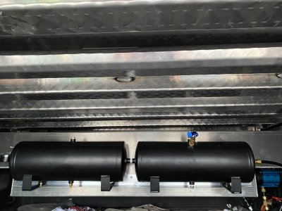

Are they interconnected by a rigid tube? The connection may be damaged due to vibration.
Yes. It is a 3/8 bass nipple that connects the two.
Both tanks are bolted to the aluminum angle iron with grade 8 bolts and also bolted to the toolbox with grade 8 bolts on the vertical and horizontal.
I have tubbing and connectors and plugs on my rig to make a repair on the fly.

Tanks hold 165 psi. I plan on installing two air hose disconnects on each side of my truck bolted through my sliders.
I need to air down the tires this weekend to 24 psi and clock the inflation time to get me back to 55psi.

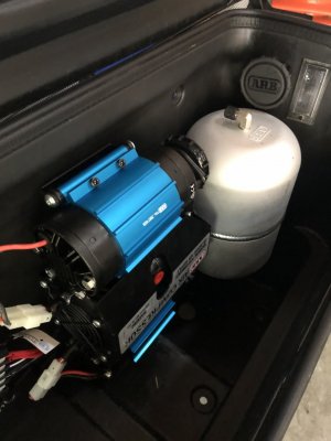

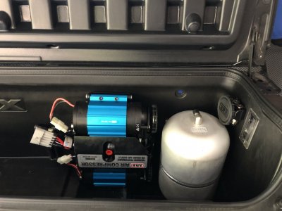

Started installing my on board air this weekend. I chose the ARB dual compressor with a 1 gallon air tank, and I placed them in my rambox on the passenger side. I'd say I am 40% of the way done. I have not run any hoses yet, and I have not tackled the wiring. Honestly I am a little nervous about the wiring. I have some limited electrical experience in the house, but I have not done any automotive electrical work. Part of me is thinking about paying a professional to extend the harness. Any thoughts or tips?
Also mounted the diff breather, but the hoses will wait for another day. This is my ARB corner.
View attachment 224434 View attachment 224435 View attachment 224436

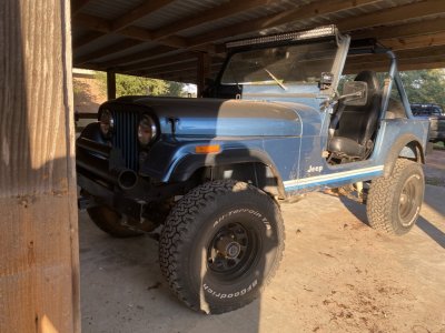

I do/did on planning on porting out a few quick connects. I have not done it. I have the line running through my bed to my horns so to add a tee under the bed is easy but drilling a 3/4” hole in my slide will take a bigger bit then I own. And I never remember to buy one when I’m at the hardware store. Seems like I air up more air mattress, pool toys and river tubes, then tires these days. I bought a CJ7 so I have been modding it lately... and trying to get in the deer blind...I will get back to the PW this winter and update my build thread with some new stuff.
Such a nice one. I typically buy/rehab TJs, I wanna do a CJ but I can't find one anywhere near me that isn't a complete rustbucket. Don't mean to hijack, we now return to the regularly scheduled thread content...
Haha. My thread to begin with anyways. I only posted the pic because I always post “ pictures or it didn’t happen” I’m building this CJ to sell. What? Road trip to Texas?? Haha.

Ha, its his thread, we can talk about jeep pics that he posts all we want.
Nice jeep, trailmaker! Thats a dandy for sure...quite jealous.
Thank you sir.
