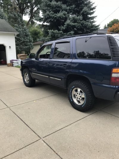

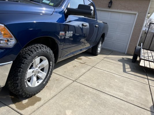

Yes P tires that required 40 psi, when I put on the LT E’s I bumped them to to 48. Truly smooth to me. Sure bad bumps in the road might be a little rougher but hey the tires not gonna blow out! MPG wise I never cared, it’s a hemi, it’s gonna get ****** mpg, and when I wanna have fun with it I have fun with it! I never see 20 mpgs on a highway but I am usually running 70mph + with 3.92 gears. Crew Cab Standard Box. Always put the same LT E on my Tahoe as well
