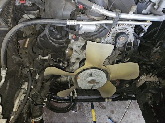

Well, D-day on my radiator change.
Loosened the oil drain plug, and.......
No coolant in the oil, THANK GOD!
My son has to replace brake pads on his wife's Kia Sportage, so have to wait a little to start the rad swap.

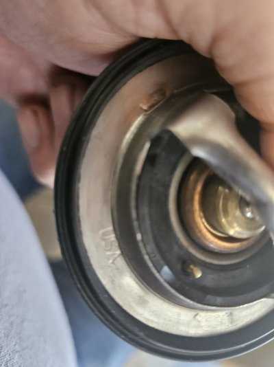

Ok, rad is out. Coolant so far looks ok.
Lost about 8-10 oz. on floor.
Thermostat was stuck in housing. In it's defense, it was the original stat, I never changed it when I changed coolant 90k miles ago.
I'm gonna sacrifice it, and reinstall without the guts, and shoot a couple gallons of distilled water into the upper hose and see what comes out the lower hose.

I have an OE stat that I bought when I did my last change, also bought a new Gates 203° that should be in the mailbox, gonna test those first, and get some dinner.
Might have to finish the job tomorrow.

Tried testing the Gates stat, and couldnt get it to open, I'm sure the temp dropped fast enough it didn't get to 203°.
Didn't really want to drop it in the boiling water on the stove, gonna use the OE stat I got for last time.

No, boiling water on the stove. If I pour boiling water over it, it doesn't open, I assume because the temp drops below 195° before the body of the stat gets to 203°. I didn't drop it in the pot of boiling water and let it sit to see if it opens.
Still might try again later.
I'm only at the halfway mark on the repair so far.

Maybe put it in the boiling water. That will ensure it is heated to at least the boiling point for your elevation. Or use a cooking thermometer and heat it to say 195, and put it in. For the stovetop test I've always put it in the water.
The gates stat I put in recently opened in 195 degree water.

I like to put the thermostat into the pot with bbq grill tongs while the water is hot, but well before boiling.
I like to see what temp it starts to open, what temp it is fully open at, then turn off the heat and see what temp it closes at.
With my folding digital thermometer, i leave it half folded and i can get the water temp without burning myself with steam.

Yeah, I'm sure I just wasn't quite right with my process. Gonna give it another shot.

My OE tstat did open on the stove, but it appeared to be at above 203° before it did.
The Gates stat didn't seem to open the same to me, seemed to not open as much.
