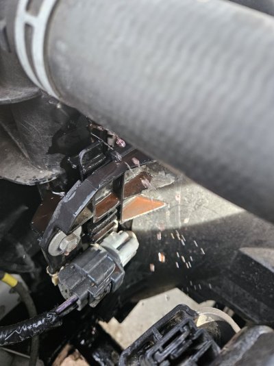

Well, finally got into checking the Ram out after getting back home and getting over the NC funk that we all got from the kids and grandkids. (Influenza A it was).
Topped off the rad and put 15 psi on it, and :
Cracked rad it is, no weep at water pump, pretty amazed for 196k miles.

Hoo Boy! It be leaking, yeah! Dat darned plastic radidiator, it be prone to dem darn cracks! ;)
Looks like right at a mold seam as well.
I have an OE tstat in the garage, gotta wait a couple days for the rad and 2 gallons of OAT coolant concentrate.
Do radiator shops replace the tanks on these? If it wasn't too expensive and was still in good shape, I would consider having it done.
I tried buying rebuilt radiators to replace the ones with Cracked tanks. Most of them failed. When I was a GM tech, I replaced many plastic tanks, with long term success. Perhaps you could get a new tank?

I just hope that the 240° didn't take out a head gasket on me.
It only took about 2 quarts to top it off initially.
I will crack the drain plug loose first to see if there's any coolant in the crankcase.
I got a rad from RockAuto, but cost $100 to ship, but was still a bit cheaper that local. Sucks that its only coming from the other side of the state, hopefully it will survive shipping.

None taken Ed,i was just razzing ya,trying to help raise your spirits.This is the worst time of year to have to spend money on a daily driver.I hope the new rad gets you back on the road.I don't think 240 would hurt the head gaskets,so i got my fingers crossed the new rad is all you need.

The rad and coolant arrived this morning, so tomorrow I will be swapping them out. Was a giant box for the rad.
Denso was the brand, and the description said OE. Fingers crossed.
