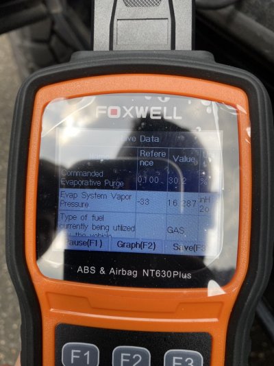

Will your scan tool allow you to see if the EVAP system is pulling a vacuum on the fuel tank? The system doesn't actually measure flow. It looks to see if it can energize and de-energize the purge solenoid and then it wants to see a pressure drop on the fuel tank by reading from a pressure sensor/transducer. Those sensors will output a corresponding voltage range.
Could be a lot of things. A line leak somewhere, etc. Can you smell fuel vapors anywhere on the system?
To me it's worth paying a shop an hour's worth of labor to smoke test and troubleshoot.
