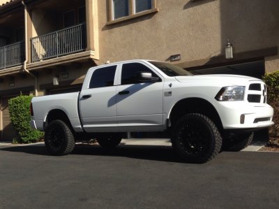

I just did this to mine

Here is the before.
