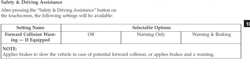

Separate settings for Front Warning Collision vs Rear Park Braking Assist. U can turn off the rear, front still function. Per MY 19 manual.sda1.JPGsda2.JPG
Yes. My 2021 is the same. It actually have two buttons that control front and rear. The issue is, it isn't park assist that is slamming on the brakes. With it off and auto brake on the brakes will still activate if you get too close to something, at least that is the way I understand the emergency braking system.
