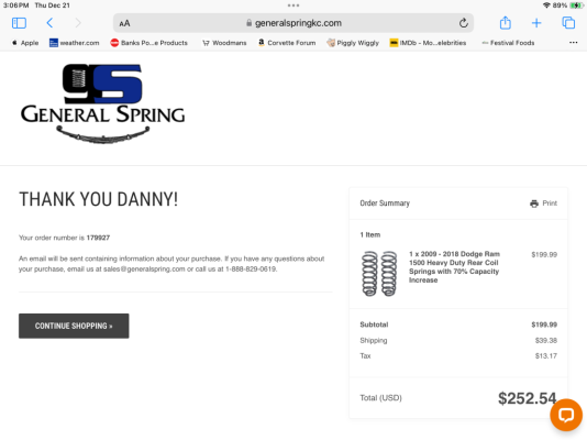

There are a lot of valid points in this thread to take into consideration both on the side of getting a bigger truck and using what you have.
To be clear on my stance, in this particular case using what the OP has said, I think he has enough truck today. I don't think stepping up to a 2500/3500 is necessary as long as all numbers are accurate. Will they tow better? 100%. Will that 1500 likely tow it well enough to get the job done? More than likely yes. Is it going to blow up? Probably not. I think if he wants to stick with a 1500 for now, it will work in the beginning, so my suggestion would be to start out with it and then after careful monitoring and towing practice, determine down the road if something bigger is warranted. I would suggest going into it with the expectation that a bigger truck "might" be warranted in the future.
All that said, I don't believe in modifying a truck to try and up its capacity simply because the truck was already designed for a certain purpose. The best way to use it (in my opinion) is as it was intended. If it's time to modify, then it's time to step up in truck size or down in trailer size. Seems to be a realist approach, or at least one that has never caused problems for those who tow within their limits.
