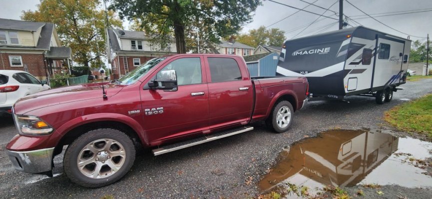

Thanks for everyone who has chimed in. Let's see if I can clear up some info. The tongue weight is the weight of my 26ft camper fully loaded with water and cargo. (usually don't travel with full water) My camper dry weight is around 5600lbs. Fully loaded around 6800lbs. My WDH weighs in about 89lbs. I've been looking at the 2025 Ram 1500 with a 1600lbs payload weight. Max tow is 10,100lbs. Here is a pic of my camper with my current 2017 Laramie. I'm doing fine with what I have right now, but we only tow 5 or 6 weekends a year with it within a 3hr drive. But in a few years, we will be looking at stretching our legs out and going on more longer trips. I've looked at the 2500's but don't know if I can swallow the 80k for a 2500 truck. But the extra 1k payload would be awesome. I'm just preplanning my future purchase and want to make sure I am crossing my T's and dotting my I's. The other huge issue is my truck is a daily driver to and from work 14miles each way.20240928_133445.jpg

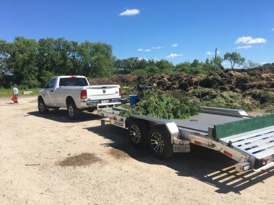

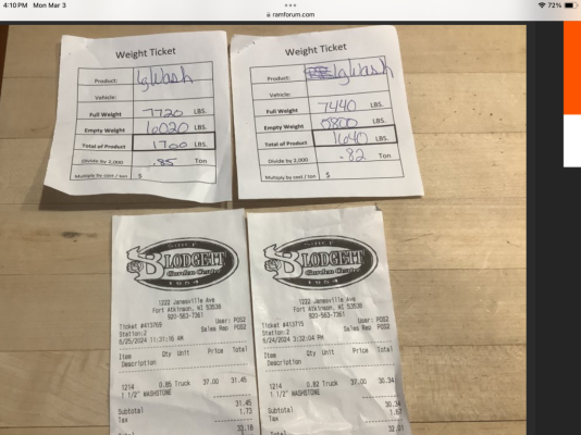

Mine is a 19 1500 tradesman and the springs were a joke. I don’t have any negative experiences from upgrading the springs (IMG_4957.pngIMG_4958.pngIMG_2905.jpeg1 ton or +70 general)and tires (e range Michelin) On the scale one trip had a passenger.

Good to know you're not a newbie at this! And always great to pre-plan what you're going to do in the future and get yourself ready for it now.
And I do understand having a tough time swallowing the price tag of a 2500 - BUT on the flip side it opens you up to the Cummins if you decide you want something a bit bigger/heavier in the future, which also gets you engine braking. And like you said, if you stay gasser you get a LOT more payload. And it's ultimately up to you - if you don't get a bigger trailer, you likely wouldn't need it. My ex-neighbor has pulled a trailer about that size all over the country with a V6 2wd Chevy and had very few issues that he's told me about. I have a friend who, on the flip side, has a trailer about that size and didn't like how his Z71 pulled it, so went and bought an F250 with the 7.3 gasser. He's got more truck than he'll ever need.
If you stay where you're at, I'd say you're going to be just fine. If you do decide to get a bigger trailer, you're going to have to keep an eye on your numbers, but I think it would still be doable.

If the 1600 lb payload is truly what the one you're eyeballing has, and If you don't plan on going to a larger trailer, based on the numbers you provided, it looks like you're just fine. A 2500 (gasser or diesel) does make for a much easier tow and gives you some room to grow in the future, but I don't think you need it at all for your current setup.
If you're eyeballing a 2500 because you want one and your only concern is daily driver duty, don't worry about it. I've been daily driving 2500/3500s for 2 decades. You get used to it really quickly and it's no more difficult to park and maneuver once you've done it for a short time.
Ignore max tow ratings... you'll never reach it with an RV before you go over payload and/or rear axle ratings. Focus on payload and axle. You can slightly exceed payload if you had to, but try not to ever exceed rear axle ratings.
I will disagree with the statement about not using the gross weight of the trailer to determine tongue weight. This has been discussed ad nauseum for decades. My take on it is that IF the trailer is capable of being loaded to that weight, PLAN to load it to that weight. Because stuff adds up quickly and before you know it, you've hit that max target and are now overloaded on the truck. It may just be enough to slightly break payload or it could be enough to exceed the rear axle rating. If you don't need the buffer you don't have to use it but it's there if you do. If you don't have it, well....
