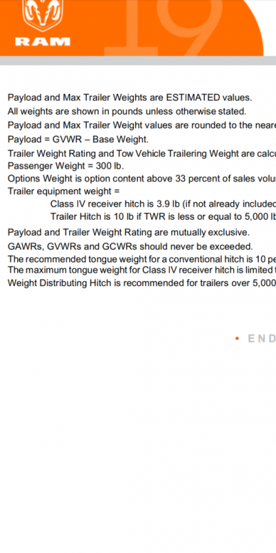

If you take base weight plus the tow number it will give you GCWR...but there is no reason to ever need to know the max tow number once you own the truck.
GCWR GVWR front and Rear GAWR and either an actual scaled base weight or using math with the payload number.
If you load the truck to GVWR you can not tow anything.
If you tow something at GCWR you must be well under GVWR before you hook up.

@Wallyb4. Every towing PDF says this. Why it makes me sad with all the misinformation that gets posted.
