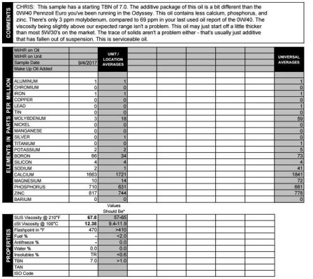

Why the euro specifically and does the warranty say use the right weight and spec? Wouldnt all the pennzoils have the same warranty? Euro usually means low saps which means low additives for diesel particulate filters. Here is a voa of that, see syn thread for more info on additives. Hemi specific oils have molybdenum. I would read fine print and see what the warranty on m3695 pennzoils have.
