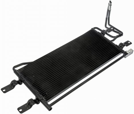

Sounds like you need to find a new place to get your oil change. The tech is clueless and if your coolant was thick, you have bigger problems than your tranny fluid miraculously finding it's way into the coolant system. In case you didn't already know, that large, flat cooler about halfway up the front of your radiator is your transmission cooler. The smaller one at the bottom is your power steering cooler.

I found out today that there is a torque converter heat exchanger...its on the rear part of the block right above the starter..A friend of mine pointed it out, I even called dodge and they said no..never heard of a thing....google it

I guess it would have helped if I had noticed you have a diesel. I'm not overly familiar with Cummins and this is the first time I've heard of that heat exchanger. Sounds interesting, but I wouldn't want one since the pictures I have found look like it is a single pass, counter flow heat exchanger using coolant. So I guess I have to retract my previous statement and suggest you drain some coolant from your radiator and compare it against fresh, clean coolant to reach your own conclusion.
