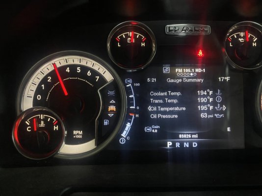

Have to have psi plus rpm to see if it is low = bearings. At 2k rpm and 3k rpm.

Here’s different temps at 2k and 3k
Also another vid from under the hood. It sounds louder from here than under the truck.

View attachment 562904View attachment 562905View attachment 562906View attachment 562907
You're past an oil strategy fixing that noise,as that's either wrist pin or rod bearing noise.You can find lots of engines on Calgary and Edmontons Marketplaces,from rebuilts to low mile used ones.

I'm thinking those psi readings aren't low enough to be bearings that plus the sound louder on top I think we can look elsewhere without more indicators. In my opinion especially with last video, I don't hear anything sounding like piston slap, now piston skirts damage is rare so I have heard that before, so possible still but I say not likely. Again, it could be lifters, they generally sound like that, but since it is a little different then garden variety, I'm not sold on it. I'm leaning towards sticky Valve or broken valve spring. Normally I have a stronger opinion, I don't in this case until I find a piece of info that makes me put all my chips in that basket. Maybe someone could be more helpful. You did a good job at getting those up, good luck with it.
