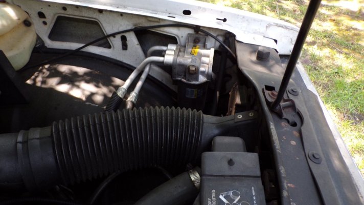

I used a Wix 57899 on mine when it was done and it's not a big filter at all.
I'll need to do a little digging to see if I can't come up with one that's longer, not fatter because it's already getting close to the block when I install it, not to mention I can't get one too much longer because of the frame/mount directly under it.
It's making me wonder about a remote oil filter setup/kit (If available) so I can install a filter elsewhere of the size I want like my S10 has - BTW that was a factory option it came with for it's towing package, it's called a remote "Oil Cooler" even though there isn't anything like a rad connected to it..... May help to cool the oil, maybe not but it's there.
Only things you'd have to worry about are how you run the hoses, run them/secure them in place and where to mount the filter block itself.
One more thing comes to mind too, over time it's hoses can get brittle and start seeping oil but that normally takes a long time to happen if the hoses are of any real quality to begin with.
Had to replace the ones on my S10 a few years ago and they were original to the truck but that was also when it was over 25 years old too with 250,000+ miles on it at the time.

That Lucas ain't doing you much good,as it's an oil thickener. You'd be better off running a good quality synthetic 5W-30 then 5W-20 and Lucas.
I run dual remote filters
