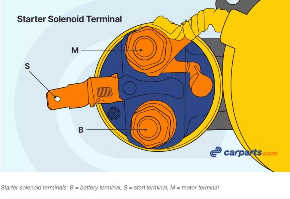

Starter Solenoid Diagram

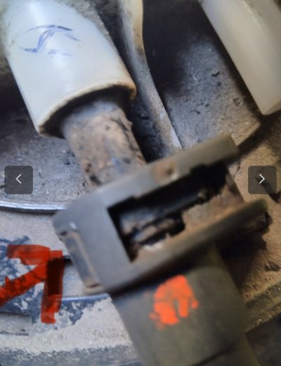

Hmmmm. I don't see my last post. Anyways I'll try again. It's got 84000 miles.attached are pics of the connector on the pump.

Do I need a pick to disconnect?
The connector is a PITA to get off for sure. On the left side do you see the square/rectangle tab with the red arrow below? Press that inward. It will force the plastic holding legs open around the tubing. Twist the tubing to break it loose and pull it out while depressing the tab. It’s normal to take multiple tries as it’s a poor design when the connection is older and dirty.
