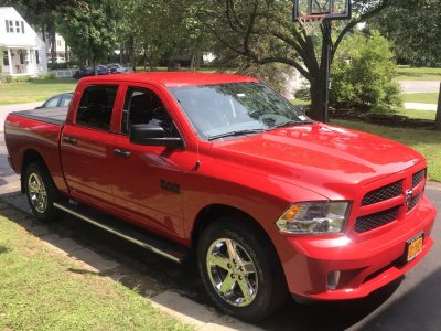

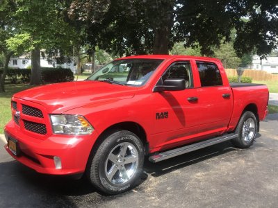

I may be using the wrong terms, I’m not looking to do any paint correction, i already had that done and I very happy with that.
At this point, I really looking to get the most shine out of the paint. Before applying more wax.
This was last weekend after using Meguires Quick Detailer. I think it looks great, but I think it could be a little better.

A good glaze will really bring out the "shine" and is usually a step before sealant and or wax. I think before the wax I would use a good sealant(because of the longevity)then let it sit overnight and then use the wax of your choice over the top of the sealant. Lately I've been impressed with Polish Angel products--I know they are pricey but the results are OUTSTANDING. Look at "autopia" and the threads about Polish Angel and look at some of the results that professional detailers have been getting--pretty amazing IMHO.
This is the results of Polish Angel--altho it is a coating I think you can still see the results.

Most glazes can be hand applied however just like most polishes it is much easier on the user if you use a buffer. If you go to autopia and go into the store and type in "glaze" you will find a number of different product manufactures offer them. If you check out the specific product, there should be a brief description along with a recommendation on how it is best applied.

You'll get a better finish using a polisher, even a cheap Harbor Freight DA will work. A finishing polish or an AIO is very good at extracting the most gloss out of your finish but it won't remove all of the defects.
