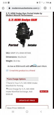

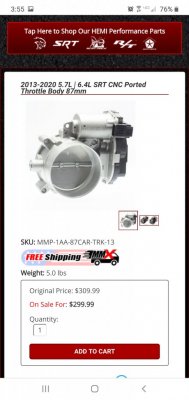

Greetings fellow Ram owners!! I have a question that's been banging in my brain the past 3 weeks. I have a 2016 1500 sport and was looking for some rumble and better breathing. I stumbled across a few intake manifold forums and was curious as to how much since it makes to run a ported manifold for 1, to couple that with a ported throttle body (87mm), include some shorty headers and a cat back exhaust. I'm not trying to go to the strip or break any speed records, just want that mean hemi sound and maybe a slightly quicker 0-60 lol thanks

Ported intake probably would not help without headers/cam.
I'm guessing they port match intake runners to head intake gasket.......not sure size on the throttle body size....stock is 85mm
Then they say on the ported TB that it still has the stock 80mm bore which would defeat the purpose of porting the TB side of the ported intake.
The stock 80mm throttle body has shown on many applications to be a restriction on these engines but with Modern Muscles new venturi-like design, airflow through the stock throttle body has been increased without sacrificing air speed (like straight bore 85mm and 90mm throttle bodies) allowing even more power while being a direct bolt-on part.Modern Muscle High Velocity Throttle Bodies are brand new CNC ported OEM throttle bodies.
I personally went with the Fastman oversize TB....... a 84mm butterfly with 84mm bore tapering to 85mm to match stock intake.
