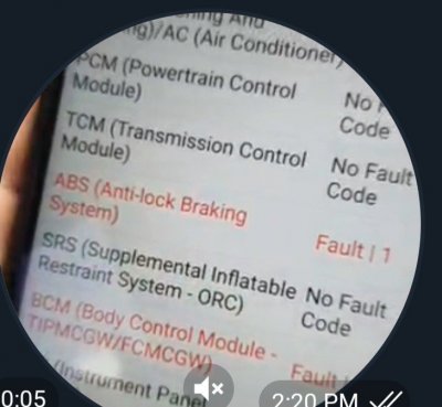

Hi guys!
Everything was fine. Once drove out of a bend and the wheels skidded a little, the stabilization light came on my speedometer and some warnings: "Service Air Suspension". After that I went to a station and workers says to me, that left side of my Ram is lower than right.
What can you say about it? What it can be? Some electronic problems or undercarriage (chassis)?
I have a screen from my app.

You can Google “rebel lean“ I believe it’s a common problem with the ram rebel. I have the limited with the air suspension and I haven’t had a problem yet I’ve had the truck for just over a year. There are a bunch of YouTube videos talking about it. Try searching rebel air suspension or rebel lean

Mine has been at the dealer for 3 weeks why they try to figure it out. They sent it to the body shop to rule out a structural issue.. they are acting like they’ve never seen it. It was also sitting on the ground about a month ago but they couldn’t duplicate it and said there was nothing in the system... Rebel Lean for the win.
