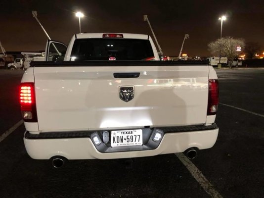

having this exact same problem now...
my cluster doesn't tell me there is a problem, but I will get flagged and told that my running lamp is out at night. usually its the passenger side one that it happens to, but I flipped the harness to the driver side in an attempt to diagnose, and it happened there too. so now it happens on both sides.
jeremy sent me another resistor to wire inline, but it doesn't seem to have done anything. this pic is taken after the resistors were installed and intended to fix. I hate it, but I might be selling and going a different route.
