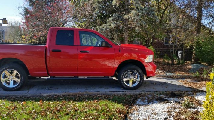

I've heard several people with the bilsteins and a 1/4" or 10 mm spacer running 35s with no rub . It's a bit of a stuffed wheel well look but it seems to work .
If bills maxed out ( top ring @ +2.8" ) makes your front too high just install a .75"-1.0" coil spacer in the back to achieve level
I would put them all around to keep the height proportionate, or more so than only the fronts being installed.
Bilsteins in the back provide no lift .
To adjust lift in the back to suffice a more accurate level it's spacers above the coil springs or air bags inside the coils to my knowledge.

So then when I put them in the front and they are maxed at 2.8... Is that 2.8" lift?
Yes ! I got 2.75" out of mine , people say they settle , mine hasn't in over 6000 miles .
These bilstein 5100s do provide lift to the front , and are primarily used to level your truck .
These 4th gen Rams typically have 2-3 inches of rake ( ass end high )
Bilstein does make shocks for the rear and a good shock imo , but they don't lift the rear .
Hope this helps !

Yes, thank you... That helps. I think I will do some 2" coil spacers in the back to keep some rake because I know the rake is good for MPG.

Thank you.. Looks good. I wonder how it would look with 33s

Looks great with 33s , you can fit 35s with with a 10 mm wheel spacer on stock rims with no rubbing . The 35s look a bit stuffed imo.
I've heard some say they didn't require the 10 mm spacer .
