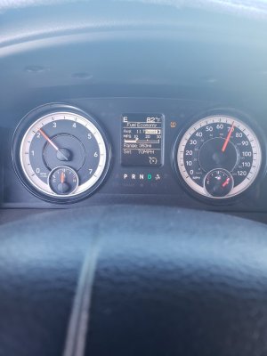

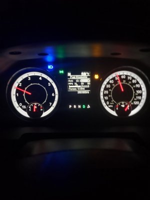

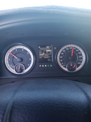

On my way to work today i grabbed these
From 60 to 70
My set up is
2017 ram 2500 crew cab long bed 4x4 with 6.4 hemi off road package 4.88 nitro gears
S&B CAI
I put 305/70r18 mastercraft cxt tires which by their description they are 35.08 tall
I have not corrected the speedo for the tires yet i just ordered the alphaobd and obdlink mx+ hoping i can do it with that system

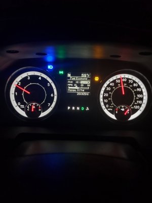

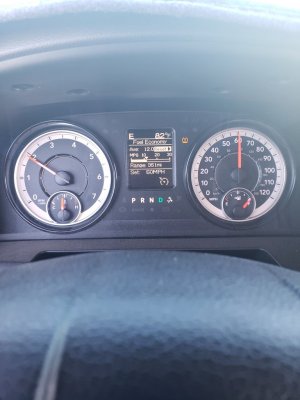

On my way home i got these at 50-55
Nickx86
Jun 16, 2018
194
121
NJ
Looks like once you get the speedo calibration done and some extra miles you should do better, but the usable torque is probably phenomenal which I’ll take that over FE since my truck is not my DD
