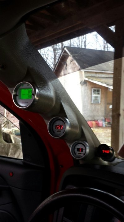

thanks man and just wondering I put my wideband on today same one you got I think and hooked it into trailor brake plug wires very easy. but when idling it goes from rich to lean and back and forth till it finally settles in at 14.7 or 8 is that normal with a cam and no custom tuning? I have it pretty far back(like 2.5 foot past where it y's into a single pipe) and have a couple of really small exhaust leaks so that could be the problem or is that part of what your high idle mod fixes

They are very sensitive and If it is reading around 14.7 then it is doing good. Exhaust leaks will affect it's reading and closer to the engine the better. I have mine plugged into the driver side **** on the header, The O2s is plugged into the passenger side **** were the original wires could reach it. The w/band is most beneficial at wot so you can check your AFR. Which should be reading 12.3- 12.6 at wot.

here it is at idle right after pulling into advance auto, but wot is perfect and everything but idle stays below or at 14.7

That looks normal enough at idle. Just make sure you are running rich enough at wot to protect the engine.
